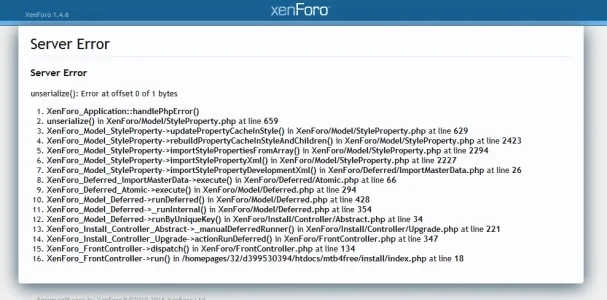

While Iam Updating to the new Version 1.4.6 I get this Error Message:
First I uploaded alle Files from the "upload" Folger to my server and overwrite everythink.
Then the folders "data" and "internal_data" got the 0777 permessions and after this I startet the Upgrade....
In my Testarea there were no problems, but the Hot Site is now down for my Users.... :(

Hi! Thank for ur help.
I added now $config['checkVersion'] = true; to my config.php and reloadet the page.
when I type admin.php at the end of my link to get access to CP, them I'am becam redericted to the upgrade-page where I have to click for continuing the upgrade. If I do this, I get the same Erros like in my first Screenshot.
now I loaded my Style named "Fusion Style" as original and I overwrite the existed Folders with the original Folders in /styles
After this I could upgrade to the Version 1.4.6 and I see my Frontend. But If I want to login to the CP, there was only a white blank page!
If I type now /install at the end of my link, so I can rebuild the Master Data or start a new Installation for the Board.
I tryd to rebuild master data, but then I got the same Error like u see in my first Screenshot.
I dont know what would happen If I start a completle new Installation....
