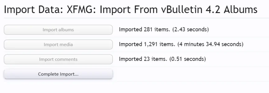

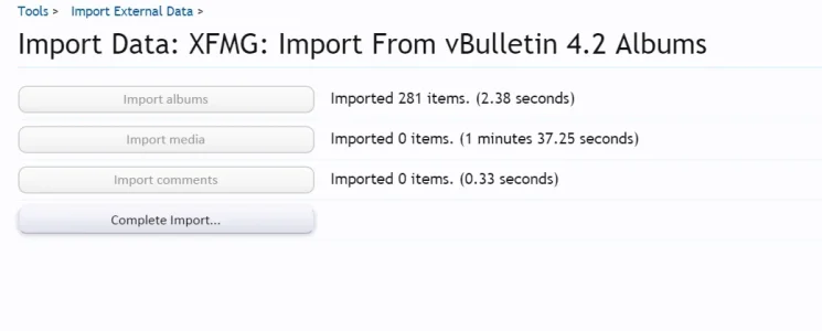

The attachments are stored in the file system.
Running your query it says the files are in "/path/attachments"
However, my resorted attachments are in "/path/sorted-attachments". The importer never prompted me to ask for the correct path.
So how to fix? Thanks!
As I thought; that's a bug then.
Simplest solution for now is to rename the attachments folder from /path/sorted-attachments to /path/attachments :)

Yeah we're still live on vB4, but I'm using a copy on a dev server to work out these migration kinks, so it's safe to change.
So I'll restore the database to before this failed import and try again.
Excellent; incidentally I have added a fix to the next release for an actual bug which may prevent the attachment path being edited. Thanks.
