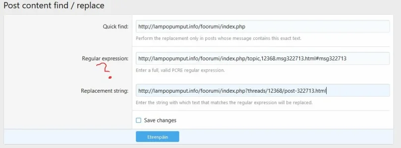

Hello! And sorry, im not familiar with regular expressions and things like that. I have pretty big forum which i upgraded from SMF 2.0.15 to Xenforo 2.0.10 (did import to Xen 1.5.18 first and then upgraded it to 2.0.10). I have a little problem with urls. I have lot of links in forum posts to another posts.
Old SMF link looks like this:
http://lampopumput.info/foorumi/index.php/topic,12368.msg322713.html#msg322713
And now it should be convert to look like this:
http://lampopumput.info/foorumi/index.php?threads/12368/post-322713.html
(and i have lot of links like these)
I googled and find this addon. I have already installed addon, but i cant understand how that regex code work... Can someone explain me the code i need to put in those two middle fields (attachment)
http://lampopumput.info/foorumi/index.php stays same, but /topic,xxxxxx.msgyyyyyy.html#msgyyyyy should be converter to ?threads/xxxxx/post-yyyyyy.html
Some script inside index.php which converts old links to new would be even better. Then google search links and links from other sites will also work..
Ok, this is now solved. We did change to .htaccess file and there are redirecting code. That way links from outside works also
