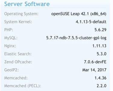

Spent yesterday getting everything else on the servers updated (the biggest issue was migrating from geoip to geoip2 and PECL memcache to memcached... a lot of code had to be rewritten especially in my Wordpress stuff). But I think now we are running live with the right prerequisites for PHP 7.1. Might give it a whirl today.
I just started playing around with OpenSUSE Leap. Its different that is for sure. Coming from Ubuntu and Centos at least.
I really like it, but I've always been fond of opensuse (before leap) and suse enterprise. One thing I didn't like about enterprise is how long it would take to get new versions of stuff added to repos since it goes through like 3 years of testing for enterprise market. Leap basically is like a combo of the two. New versions of stuff combined with stuff taken from suse enterprise (for example infiniband hardware support which I need).
