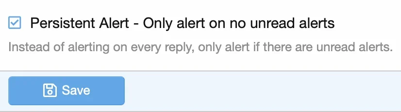

I'm a bit confused by what this means, the description seems to contradict the title.
Is it unread alerts or no unread alerts????
198605
That should be "no unread alerts", typo.
Thought it must be!
I am a bit confused because surely if they have no unread alerts, then they would be getting alerts anyway, without the addon?
I'm doing some testing and it seems people are still only getting alerts when they have followed the link.
How should this actually be set for its most aggressive setting, ie all users get persistently emailed (without opting in) of every messages in any forum they are watching and getting emails for messages?
I may need to double check this still works with XF2.1 :(
If the alert is marked as read, they will get a new alert. Following the link just makes it as read with XF2.1.
Check "Persistent Alerts - Ignore Last Read Date", and uncheck "Persistent Alert - Suppress Persistent Emailing" and "Persistent Alert - Only alert on no unread alerts". This is the most aggressive option set.

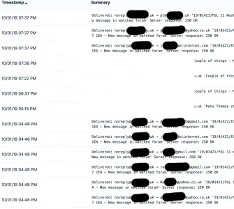

I'm a bit confused about how to test this is working as I expect because some users say they are not always getting notifications. I have options set as above. There are about 8 users who are watching a forum for New messages and email alerts. (I have double checked they have that set for the forum using xenConcept login as user)
My understanding is that with watch messages and options set as in quote above, then they would get an email notification for every single message posted in that forum whether they visit or not after notification.
But my mailgun logs are showing two seats of notifications for posts in the thread title "19/01421/FUL - one at 4:48 and one later at 7:37
As you can see there are 6 notifications for 4:48 and only 3 for 7:37
So either there are notifications that don't even show up in the mailgun log or else some are not being sent????
The behaviour above looks a bit like you would expect if there were no persistent alerts, ie some (3) of the users alerted for the earlier post followed the link but the others didn't - shouldn't it show the same 6 users?
I'll need to look into this, with that configuration it should be alerting for every new post
Thanks xon, it is very hard to test on something like this, members may not be happy about loads of test posts or itrelevant posts just to see what's happening with the notifications.
