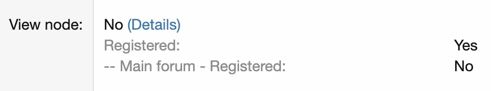

Example A
Permissions analyzer:
View node
No (Details)
Registered Yes
Promoted Yes
-- Child #1 - Registered No
END
(Does not show Promoted's permission here when on Inherit, and is not inheriting the Yes from Cat #1 or the group level, tried both.)
-- Child #1 - Promoted Inherited (Yes) this line is missing, I simply typed it so you could see.
It doesn't list the Promoted group in the child, but I have it set to Inherit, so it would be inhering the Yes from the parent. The only way I can get it to work is to set the child to Yes for the group Promoted, but Inherit should work.

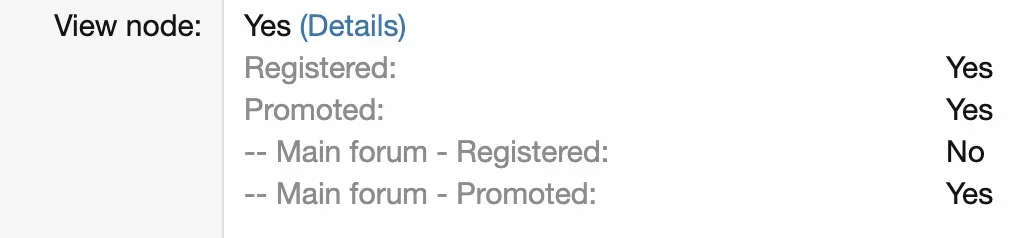

Example B
View node
Yes (Details)
Registered Yes
Promoted Yes
-- Child #1 - Promoted Yes (Why doesn't Inherit work here since the parent is Yes?)
Summary: Example A should result in Yes, since the child (forum) node should be inheriting the Yes from the parent (category) node.

Some points that I think are relevant:
1) You don't need to set any permissions on the category because, as you rightly pointed out, the default for the group is to view all nodes anyway.
2) By setting the forum to "No" on the Registered group that correctly prevents anyone in the Registered group from accessing the forum.
3) Inherit from a parent node cannot override the "No" from a group in the current node.
4) Therefore you need to set the Promoted group to "Yes" which would override the "No" from registered.
Taking all of that into account members of the Promoted group will see the forum.
Members not in the Promoted group will not see the forum:
So realistically, I'm not seeing what you're reporting here and it is working as expected.
But Inherit does work if there is no category to pass through. I didn't have this issue when I had forum nodes only, no parent. In the forum node, Registered was No, Promoted was Inherit. In this scenario they can see the forum when in both groups as it inherits the Yes from the group. I then added a category as a parent and it denied it when trying Inherit and Yes. So why would it work in nodes without parents?
That just wouldn't be how it works and, indeed, if I move my current "Main forum" out of the category and change "Promoted" back to inherit, the resulting view node permission is "No" on the basis that view is revoked for the registered group.
This is the way I had it:
Group:
Members No
Promoted Yes
Forum Node A:
Members Yes
Promoted Inherit
(Both groups can see; correct)
Forum Node B:
Members Inherit (can't see; correct)
Promoted Inherit (can see; correct)
Once I added a parent, no go.
Yes, that would be the expected result.
In this scenario Inherit works because there is nothing at the same level to override it.
In the other scenario you have Members set to "No" so that overrides the Promoted set to "Inherit".
I guess I misunderstood inherit. I always thought it was taking what was above it in which case a Yes which would override the No next to it.
