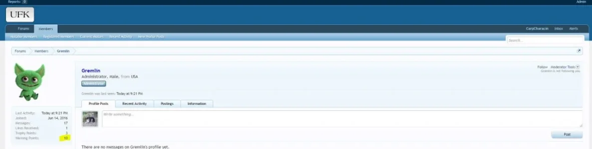

I was trying to ban a user by giving them 10 points and that didn't work so I have them 10 more and deleted the old warning , but even though the user only had 1 10 point warning, the user had 20 points. I removed the other warning so the user had no warnings and the 10 points remained.

I gave it and removed it before I had any add-ons installed. I can't reproduce it consistently. I can't get those 10 points off. I also can't get it ban users at 10 points, even though I set it to do that.
