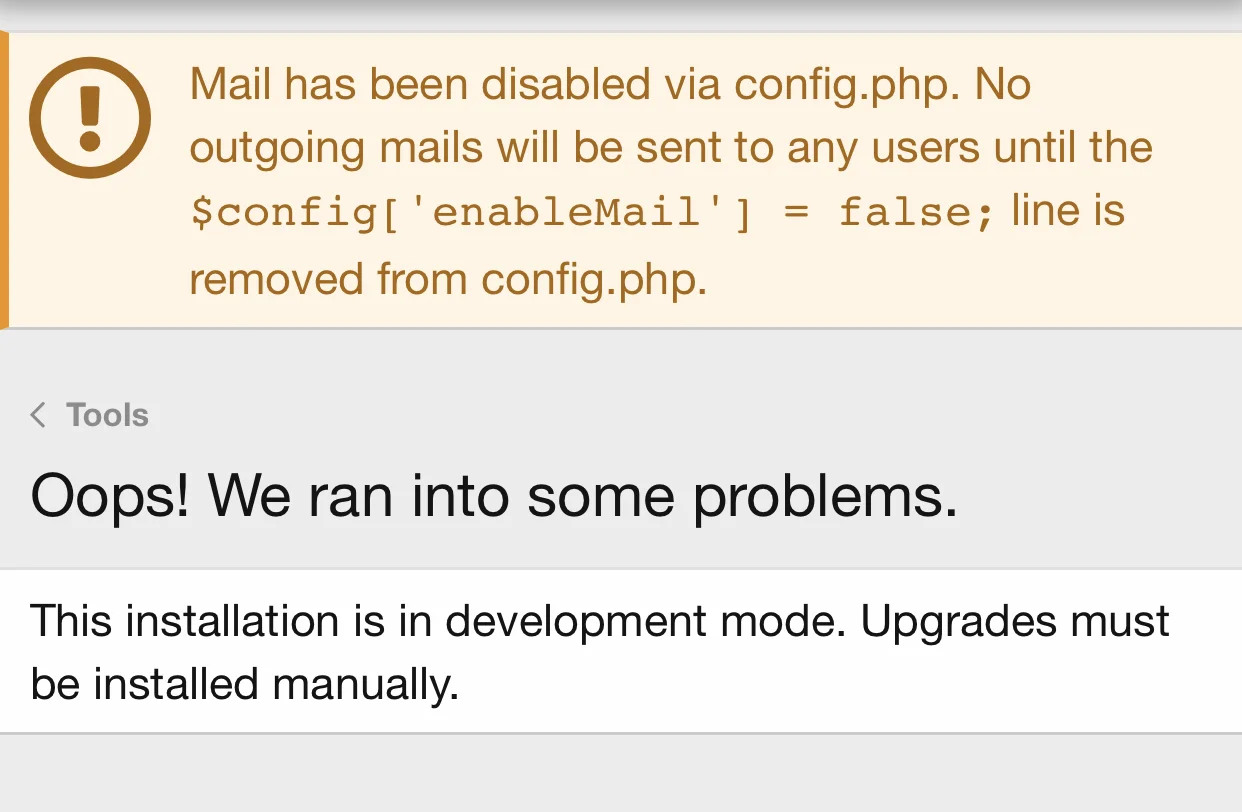

Not able to use one-click upgrade (Beta2 -> Beta3)🤔

That won't be why. We don't block it in that case.
Have you unchecked "Only check for stable upgrades" in Options > Basic board information?
That was it. I was pretty sure I had that unchecked initially, but when I just looked, it was checked. Perhaps I forgot to save it...not sure.
