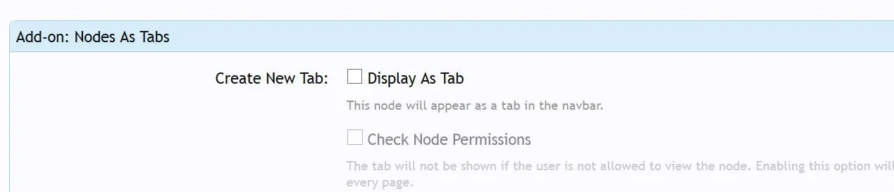

I check this check box (Display as Tab) but after saving, I find that it is unchecked automatically. (image attached below). I tried it with one of my categories (Member Area www.IndianParentsForum.com/community)
This is the first time I am using this add-on. So I don't know if I am missing something or if this is because of XF 1.4
Thanks for the add-on (y)

It works fine on my test forum in XF 1.4.
It could be another addon conflicting with mine. Try disabling your other addons to test this.
  • Like
Reactions: IPF
Thanks @Jake Bunce.
I got this error Zend_Db_Statement_Mysqli_Exception: Mysqli statement execute error : Deadlock found when trying to get lock; try restarting transaction - library/Zend/Db/Statement/Mysqli.php:214.
But everything started working after this. I enabled the other two add-ons and they work too.
