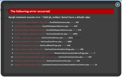

Seems, I have an issue with Nodes as Tabs... Whenever I try to save a new page node, I get the following error message:
Someone in another Thred said, maybe Nodes as Tabs is causing this error.
The new page node I try to save is not marked to apear as a tab.
Thanks for help.
Thanks for help.
That is not from this addon.
It appears you have (or had) another addon which created the ph_extdesc column in xf_page or xf_node. You could remove that column, but it may affect whatever addon created it. The safe thing to do would be to edit that field definition (using phpmyadmin) so that it has a default value. That should avoid the error.

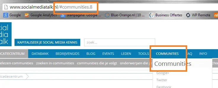

got some strange thing going on.
i cannot change the route of this node as a tab. what am i doing wrong here....see visual
now its like this.....#communities.8
must be like this..../communities/
