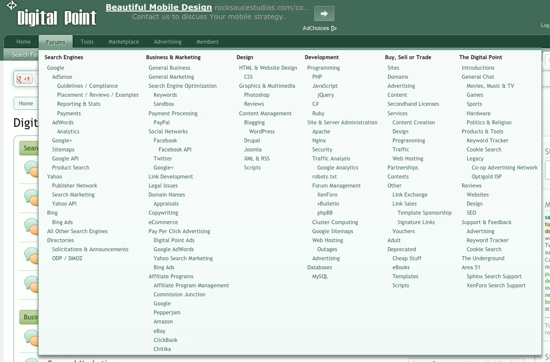

Added option to display popup menu links as columns. This allows you to recreate the "JumpMenu" from https://forums.digitalpoint.com/ which is what inspired this feature request.
It is mentioned in the description of this new option, but I will also emphasize it here. Those wishing to style their column menus to look like digitalpoint need to edit the nat_public_css.css template. I have included special CSS that you can uncomment to make your...
