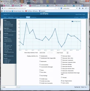

The daily stats report for the last month shows no registrations since two days before we migrated to Xenforo.
Is something not set up right?

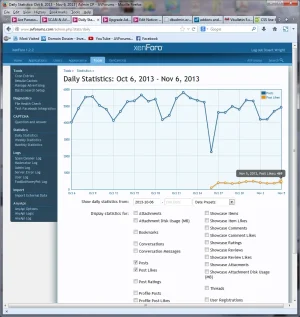

Forgot to update this earlier.
So the issue was that the daily stats Cron entry was timing out.
@Mike very kindly gave us some advice and the solution was to add an index to the xf_post table on the post_date column. Ideally you should only do this if you're having issues, and preferably only via shell and while your board is either closed or very quiet. If you have a lot of posts it will take a considerable amount of time.
The Rebuild Statistics cron now runs within seconds, though.
