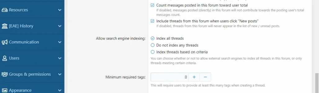

How many have an "Off Topic" forum?
Have you ever thought about "no-indexing" it?
Is that possible in the CMS, without editing the template?
I always wondered if there might be an advantage to this, keeping all (or most) of the UGC on topic.
It's already possible in XF 2.1.x
AdminCP >> Forums >> Node Permissions
Set all to No for Unregistered/Unconfirmed group: that way search bots will never see it.
