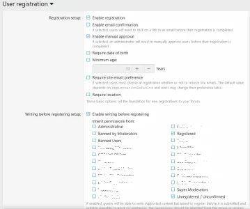

From what I found, xenforo automatically or by default, drops these new registrants temporarily into the 'registered' category instead of the 'unregistered' group. (It states it in admin/options/user regis/allow writing)

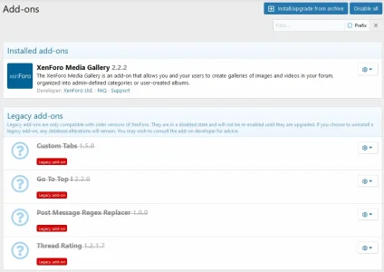

I have no add ons turned on, and haven't for quite some time
by 'new users', I meant '
Approval queue​
they are in there awaiting action,
but still able to do as stated,
fyi showing my add ons and status

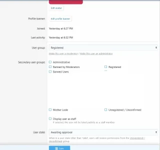

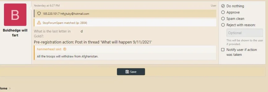

Hi Mike and Brogan, and thanks! I do appreciate the help on this,
I have more in the que now, so I took some screenshots before doing anything,

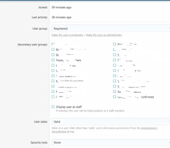

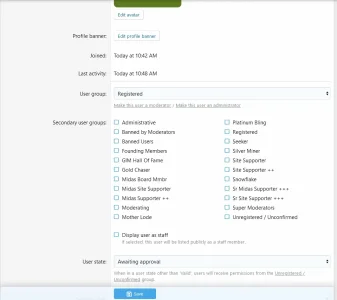

The first screen shows new registers, top one is fine, the other 2 on the bottom are my boy playing games
the second screen shot is what is showing in admin under 'user', where I copied and pasted his name into 'search for users'
We can see that it is listed into 'user group' as 'Registered', which of course is where it is pulling the permissions from,
This allows that person temporarily to 'like' posts or other
This shows more completely what I have been trying to communicate,
That is incorrect.
As I posted previously:

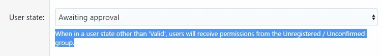

However, until they are confirmed, they receive permissions from the unregistered/unconfirmed user group.
Your screenshot clearly shows the state is not valid.

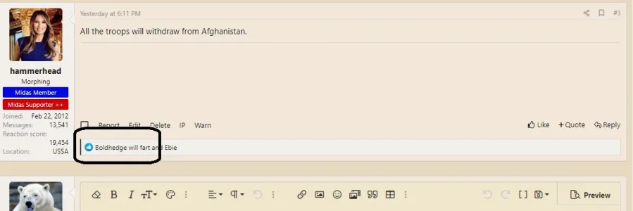

yes, exactly (regarding that content you refer to) and that is why I came here,
I understand what you are saying for the 'user state',
but this person is creating these nics and able to 'like' posts, which you say cannot happen
Trying to get to the bottom of it and figure out how they can operate,

Again, the permissions for users with a non valid state come from the Unregistered / Unconfirmed user group.
If users in that state can like content, it means the permission is set to yes in that group.

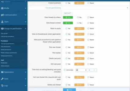

I realize what you say is how it is supposed to work,

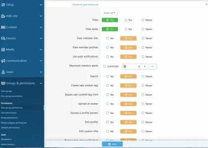

Here is my most recent incantation, note the user, the state and status, the ability to react, and the permissions setting for that group
as I stated, the permissions are set properly, and yet the guy can 'like' posts
I have a glitch for whatever reason,
