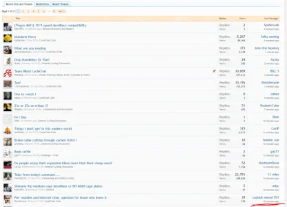

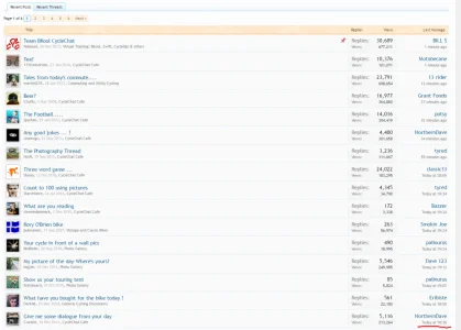

@Thomas.B something is seriously wrong with my Recent / New posts pages on CycleChat.net with this add-on enabled - it doesn't appear to be working at all as expected.
With the add-on enabled the first page of results for Recent Posts for guests, for example, is a list going back hours and hours to much earlier in the day - when in fact there are enough posts within the last 45 mins to fill the page.
What would you need from me to troubleshoot this please?

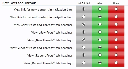

Okay, here are my settings for guests (who can only view Recent posts):
I don't want a tab of new posts and threads so have disabled that one - this should give me two tabs in the recent posts results - Recent Posts & Recent Threads - which it does:

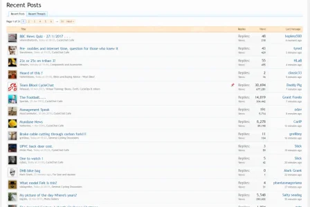

However, the Recent Posts results don't include all of the recent posts:
There are many more new posts than that, which is evident when I enable the Recent Posts and Threads tab:
Sooo ... do I need to disable the 'Posts' tab and rename the Post and Threads tab to just Posts?

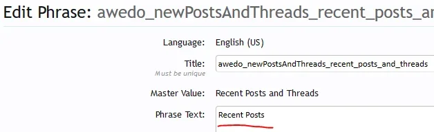

From experimenting with turning the permissions on/off I've found that the tab [Recent/New] Posts and Threads actually shows the full results I'd expect, rather than [Recent/New] Posts which seems to show a very limited selection and nowhere near all of the posts it should.
So my solution has been to rename the [Recent/New] Posts and Threads tabs to [Recent/New] Posts and disable the actual Posts permission so that tab is not shown:
I guess the problem was the terminology. It can indeed be somewhat confusing as this add-on defines the term „new/recent posts“ differently than XenFore (see description). For example, the XF „New Posts“ are the same as „New Posts and Threads“ in this add-on. Unfortunately I had to redefine these terms as otherwise it would probably be even more confusing..
Okay, no problem, thanks Thomas - I worked it out and after adjusting the phrases it is now working as expected.
Thanks for the prompt and full reply. (y)

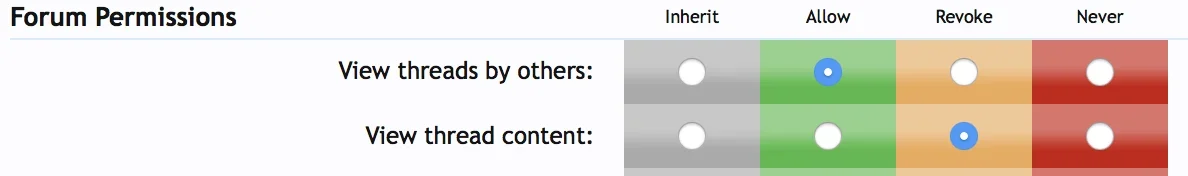

I have a category of forums where permissions are such that folks can view the thread titles but they can't view the thread content unless they are a member of that usergroup. It's been a great way of getting folks to pony up for a membership.
Is there a way I can adjust this add-on to honor those settings? As it is it completely excludes threads even though the non-member user has permission to view the thread title so those threads are not showing up at all.
Attached is an example of a non-member's permissions for the member only node.
Thanks!
