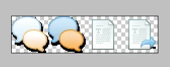

This is what the node sprite looks like (node-sprite.png):
I will basically use this image and save the different versions of my icon side by side here? Where can I tweak the sprite coordinates?
