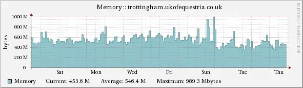

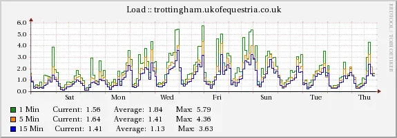

The load and memory stats are attached - I made the tweaks mentioned above on Sunday, to no avail. Was abandoning Apache all those months ago an unproductive waste of my time? Any ideas or suggestions you could give will be greatly appreciated.
