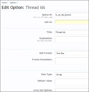

In Option to add-on, i have:
The problem is that my code is displayed only in the thread with ID 8 but not with ID 17
It does not take into account ", 17"
Someone would have any idea ?
If i put this, it work:
<xen:if is="in_array({$thread.thread_id}, array(8,17))">
If i put this, no:
<xen:if is="in_array({$thread.thread_id}, array({$xenOptions.tc_st_ids_block2}))">

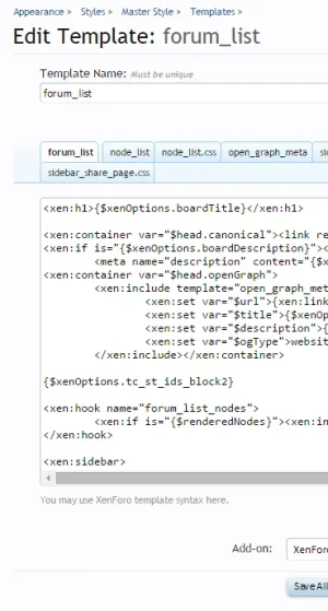

If i add this in thread_view template:
{xen:helper dump, $xenOptions.tc_st_ids_block2}
Result:

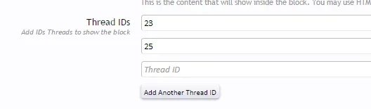

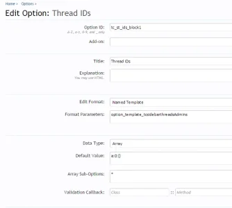

@Chris D , i would like use several times this fonction:
I create a new template (option_template_tcsidebarthreadsAdmins) with the same content as the option_template_facebookAdmins template for my Option.
I use the same system several times, but the button does not function to operate on one of two. I use several times the same template? (option_template_tcsidebarthreadsAdmins)
My option is correct ?
Look the gif: https://gyazo.com/6d7a49b7fa5eee346c55ce2751aa6044
I wonder if I need to create several templates with the same content but a different name for each option?

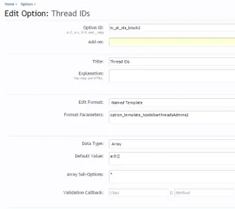

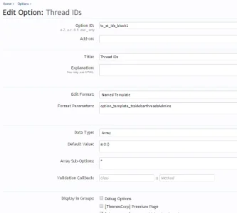

Strange, it don't work.
Example, i create 2 template:
- option_template_tcsidebarthreadsAdmins
- option_template_tcsidebarthreadsAdmins2
Same content for both templates:
<xen:controlunit label="{$preparedOption.title}">
    <xen:html>
        <ul>
            <xen:foreach loop="{$preparedOption.option_value}" value="$admin">
                <xen:if is="{$admin} !== ''">
                    <li class="fbAdmin"><xen:textbox name="{$fieldPrefix}[{$preparedOption.option_id}][]" value="{$admin}" placeholder="Thread ID" /></li>
                </xen:if>
            </xen:foreach>
            <li class="fbAdmin"><xen:textbox name="{$fieldPrefix}[{$preparedOption.option_id}][]" value="" placeholder="Thread ID" /></li>
        </ul>
        <div style="margin-bottom: 5px"><input type="button" value="Add Another Thread ID" class="button smallButton FieldAdder" data-source="li.fbAdmin" /></div>
        <input type="hidden" name="{$listedFieldName}" value="{$preparedOption.option_id}" />
        {xen:raw $editLink}
    </xen:html>
    <xen:hint>Add Threads IDs where to show this block</xen:hint>
    <xen:explain>{xen:raw $preparedOption.explain}</xen:explain>
</xen:controlunit>
My options:
I made a mistake ?
