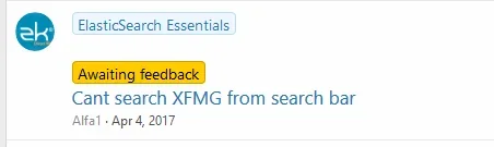

Hey,
I tried various possible css tweaks but I cannot get it to work. Please help. This tweak worked for me when I had single prefixes, now with multiple it doesn't work anymore.
How can we display the prefixes above the thread title (because that way it is way better for people to read)?
From this:
to this:
display: block does the job, but in the title we cannot target the title-text alone. There is no css selector.
If I target .structItem-title .label which worked for a single prefix, then this happens:
It gives each prefix a new line.
Any ideas?
