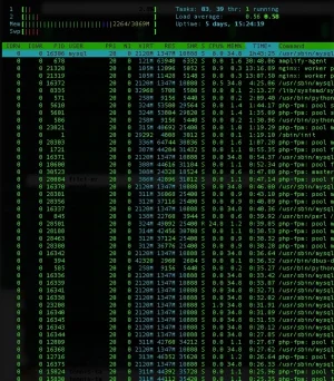

uhmmmmm stop the press!!!
I adjusted again my.cnf with suggestion from mysqltuner and now it is fast and stable... I noticed that the cache (in htop) is much lower now and it used some swap.
All of this with more users connected than last days... Maybe I'm still on the edge but now I have a little more time to choose the new server.
