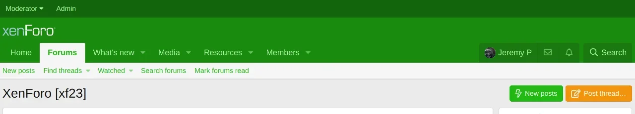

It's difficult to say definitively at this time, but changing the hues from blue to green really should be so simple that I wouldn't let it hold you back. The dark variation takes it from making roughly the same change to 5 style properties to making roughly the same change to 10 style properties.
If you note, the current palette hues are 204-206 (which might as well just be a rounding error in the RGB->HSL conversion). Changing them all to eg. 115 took me about 30 seconds and yields this:

I would start by just changing the hues in the color palette, which should only take a few minutes and accomplish the bulk of it pretty easily. Then you can tweak further as necessary.

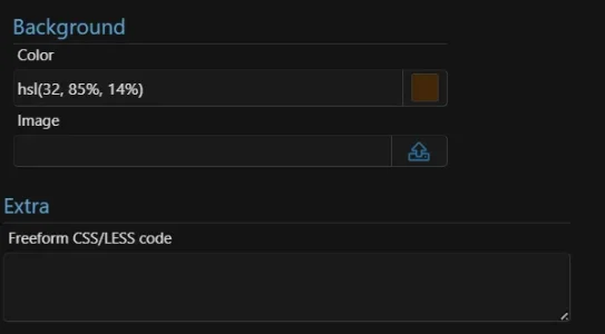

I tried to change the footer background, but it seems that an extra css code overwrite the chosen colour:
But as you can see the Extra css field is empty, it should be field with the css code for the gradient bg which would allow it to be deleted (as header block).
The footer background still have the gradient bg...

I can’t reproduce that, the footer is whatever the chosen color is for me. The default footer isn’t a gradient either so probably down to a style customization.
