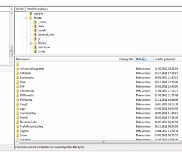

You must upload their folders inside your library folder maintaining the structure intact. Then upload the mod .xml file and you should be good to go.
All mods, when possible, should be installed by uploading the .xml (installer) from your home computer file using the browser window....I was confused originally by trying to load them from the server!
I agree that the uploading is a bit confusing - at first.
But once you do one correctly, you will get the idea since they all end up in the same directory.

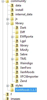

Check out the ftp screenshot uploaded - that shows all the addon directories inside the proper XF directory.
Note that I did not name those directories - the authors did.
(yourpathto_mainwebroot/yourxf_url_segment/library/

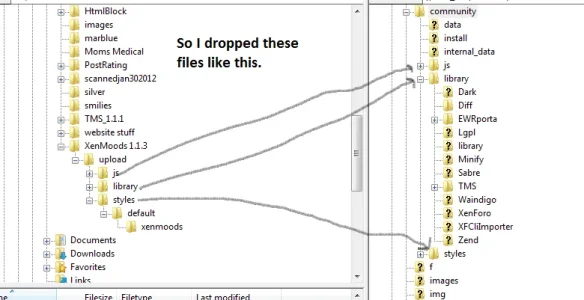

Ok but in the moods mod, it has js, styles and library. So I dropped the library in the library, dropped the JS in the js and dropped the styles in the styles. But it's still not showing up. I see the "mood" in my control panel but the icons are not showing up in my CP or in forum. I moved this around everywhere and I still get the same thing.
I'm sure I"m doing something wrong. It isn't the mod for sure. It is me.

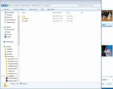

I hope you didn't drop the JS folder in JS, so it creates a structure like this /js/js - That should not happen.
You merge JS plugin folder with JS folder found there originaly.

"To begin, upload all the files in the upload/ directory into your XenForo base directory (the one with library/ and styles/)."
so, if I read that right, with that mod you would be uploading styles, js and library INTO the library directory? And then the .xml file would properly place them?
If so, Gabby, you still appear to have them in the wrong directory!
I'm somewhat technical and still find the instructions for this stuff a bit lacking....but, then again, I probably don't read them closely enough!
AH, it appears this one wants you to upload it ONE DIRECTORY up from there....BASE!
This sounds confusing since it would overwrite your existing files? Hmmm....
