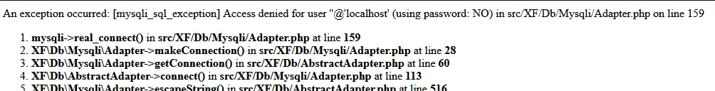

Clean install isn't accessing the install module (or whatever it's called). I just get the following errors:
An exception occurred: [mysqli_sql_exception] Access denied for user ''@'localhost' (using password: NO) in src/XF/Db/Mysqli/Adapter.php on line 159

Host says it's not their issue. I've been with them for 16 years, give or take, and I have a Xenforo install on another site. IIRC, I type in the URL/forum/install, and it opens up prompts to fill in database credentials.
Now, I can go in populate the config.php file, but all that does is reduce the errors by one line.
I'm a bit baffled.

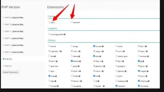

This was on a list from my host:
The red X is for Shared space (which is what I have).
Ok, so caching won't be an issue I guess.

I am curious about what I found on another topic from someone who had the same issues I'm having...
Was that the final solution?
If so, what host are you using and what type of server space?
