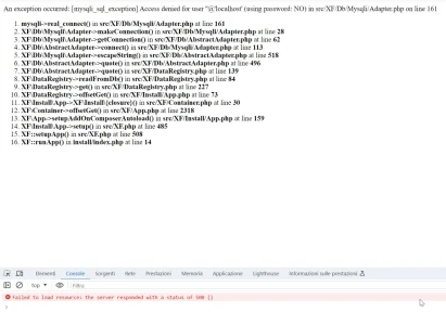

I'm trying to perform a fresh installation of XenForo 2.2.7 for a new project, but unfortunately, I'm encountering an issue right from the start. As soon as I attempt to access the URL to begin the installation, I receive the following error:
An exception occurred: [mysqli_sql_exception] Access denied for user ''@'localhost' (using password: NO) in src/XF/Db/Mysqli/Adapter.php on line 161
mysqli->real_connect() in src/XF/Db/Mysqli/Adapter.php at line 161
XF\Db\Mysqli\Adapter->makeConnection() in src/XF/Db/Mysqli/Adapter.php at line 28
XF\Db\Mysqli\Adapter->getConnection() in src/XF/Db/AbstractAdapter.php at line 62
XF\Db\AbstractAdapter->connect() in src/XF/Db/Mysqli/Adapter.php at line 113
XF\Db\Mysqli\Adapter->escapeString() in src/XF/Db/AbstractAdapter.php at line 518
XF\Db\AbstractAdapter->quote() in src/XF/Db/AbstractAdapter.php at line 496
XF\Db\AbstractAdapter->quote() in src/XF/DataRegistry.php at line 139
XF\DataRegistry->readFromDb() in src/XF/DataRegistry.php at line 84
XF\DataRegistry->get() in src/XF/DataRegistry.php at line 227
XF\DataRegistry->offsetGet() in src/XF/Install/App.php at line 73
XF\Install\App->XF\Install\{closure}() in src/XF/Container.php at line 30
XF\Container->offsetGet() in src/XF/App.php at line 2318
XF\App->setupAddOnComposerAutoload() in src/XF/Install/App.php at line 159
XF\Install\App->setup() in src/XF.php at line 485
XF::setupApp() in src/XF.php at line 508
XF::runApp() in install/index.php at line 14

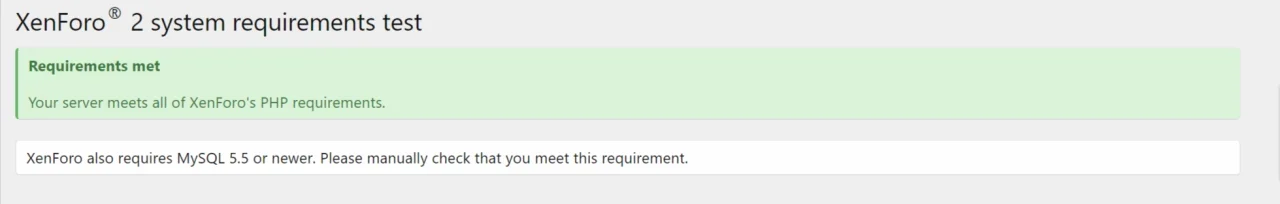

How about the XF test script? Does that work? (Download from here...)
Yes, I tried the script.

Google console interprets it as error 500.

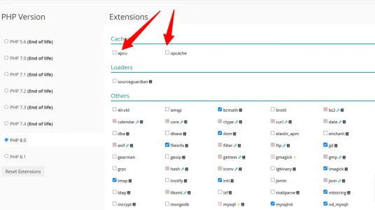

Thank you for your responses. They will certainly be useful for similar scenarios. In my case, as I described above, regardless of the folder or domain (always on the same host) where I was uploading the files, when I clicked the link to start the installation, instead of the installation interface, an error message appeared. Only after disabling the cache extensions was I able to proceed with the installation. It's likely that some cache from a previous installation was lingering in memory, preventing me from moving forward.
