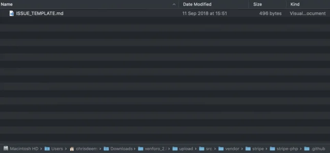

Honestly, they definitely are in the download package:
But as I say, they'll be hidden by default. Either your OS is hiding them and as a result they don't end up being passed to your FTP client or your FTP client does see them and throws them away.
It's something we'll have to try and remove from the download files going forward, so hopefully won't be an issue in the future.
