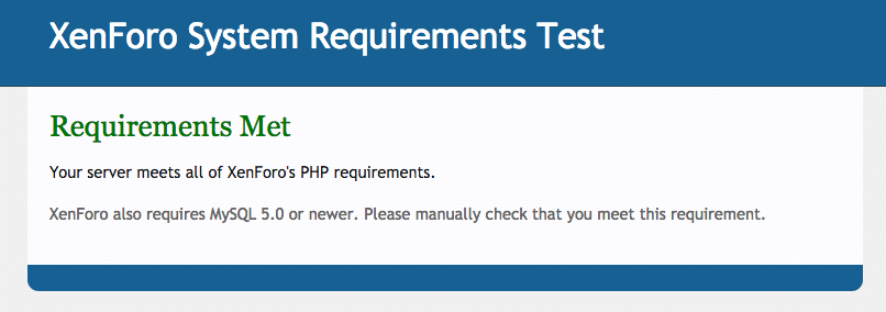

Currently the forum works but it's not able to read data from database. Also I tried to connect to the admin panel but I'm not able to login (no error shows).
I think that the database connection is not working.

If the forum works, the database connection works -- if that didn't work, you wouldn't have anything displayed.
We'll need you to be a little more specific about what problems you're having and exactly what behavior you're seeing.
The new forum appears to be closed, so I'm not 100% sure what you're referring to. Do you mean the 404 error on non-root pages? That would usually indicate that the .htaccess file was not migrated from your old server or that your new server doesn't read them (because of the default AllowOverride value in your Apache config; see discussion of concept here). If it's just the file not being migrated, you can rename htaccess.txt to .htaccess on your new server.
