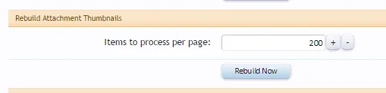

This is why there's a configuration step before rebuilding thumbs:
Reduce it from 200 to something more manageable; even if it's as low as 10, that will drastically reduce the amount of time it takes on each page, and probably won't go near your max execution time.
