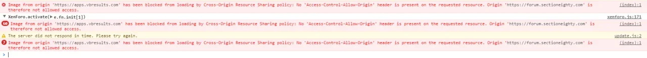

Have you got any more info? Any errors in the browser console (F12).

these errors appear when i receive the alert
I'm not certain, but it could well be the Cross-Origin policy error as is being reported.
It would seem that every time the server is polled for LiveUpdate it brings down this image:
https://apps.vbresults.com/libraries/smart-app-banner/img/sectioneighty.com.png
I've looked at the response coming back from the live updating polling, and the response does not include anything other than a small amount of text containing the info needed to update the alert/inbox count.
I think the first step would be to sort out this cross-origin error -- that would appear to be coming from the smart app banner. If that is resolved and the issue with live update persists, let me know,
