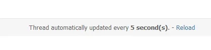

@Xon I am have one Feature improvement request. Please add this functionality.
Option: Enable Information Bar (Tells users how often the thread refreshes ... etc) and Ability for users to manually refresh threads if Automatic Updates are disabled.
Example:
Where do you think it should be added? It may need to be a floating thing at the top of the page or such to be useful.

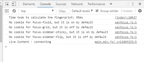

Check your javascript error console. The default polling is also every 30 seconds which you might need to adjust.
The last line "Live Content - connecting" indicates it has started to poll. Can you check on the network tab that you are seeing a ping /live every so often?

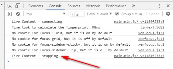

@Xon This error after clicking the "Live Content - stopping" main.min.js link.
function(){console.log("Live Content - connecting")});a.on("disconnect",function(a){console.log("Live Content - stopping")});a.on("error",function(c,d){304===c?console.log("Live Content - stopping"):console.log("Live Content - stopping, http error:",c,d);a.running&&a.stop()});var l="keepAlive"+XF.stringHashCode(XF.config.url.keepAlive);XF.CrossTab.on(l,function(c){c.csrf&&(a.transport.opt.headers._xfToken=c.csrf)});a.start()})}(jQuery,window,document);
In network tab.
Live thread update are not working and console showing "Live Content - stopping"
In network tab.
By design, if a 304 is returned it stops polling. This happens when you don't have permission or when viewing a thread the user can't reply to with the "Liven non-replyable content" disabled (which it is by default).
Please run an analyse permission check and verify the user can reply, and the "View live threads" permission is permitted for a given forum

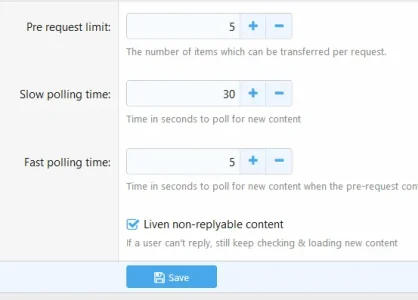

But I have already enabled option "Liven non-replyable content", Also i have permission to reply to this thread as i am super admin. So why not updated thread?
