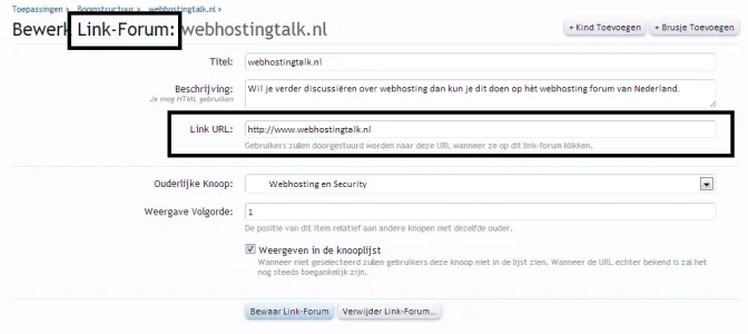

Echelon
Whatever I do......target_blank, target_new, <href......
can't get it done to have the link open in a new window
check visual.
what is the code to have the link open in a new window

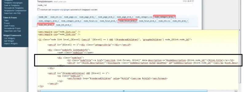

Mike explained it in the second post:
You would need to modify the templates that link to these forums (node_link_level_*).
Thanks Jeremy. I got there.
For anyone else not confident on this here's the code:
Go to template node_link_level_2
Count 8 lines down, and insert the blue bit of code where it's shown below.
Rich (BB code):
<div class="nodeInfo linkNodeInfo">
        <span class="nodeIcon"></span>
        <div class="nodeText">
            <h3 class="nodeTitle"><a href="{xen:link link-forums, $link}" target="_blank" data-description-x="#nodeDescription-{$link.node_id}">{$link.title}</a></h3>
            <xen:if is="{$link.description}"><blockquote class="nodeDescription muted baseHtml" id="nodeDescription-{$link.node_id}">{xen:raw $link.description}</blockquote></xen:if>
        </div>
    </div>
The only drawback is this means that ALL link forums will open the link in a new page.
