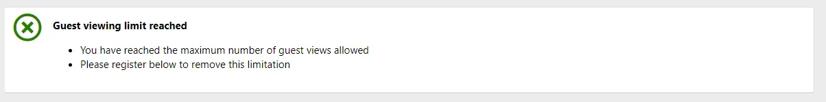

Thanks. I tried that and it still came out red :( Edit. I had missed the first line off. That works :) There is still a red cross though and a red line round the border of it.
This is what I get with the default style using the code below:
.blockMessage.blockMessage--error
    background: white;
    color: black;
    border-left: 0px solid white;
.blockMessage.blockMessage--error.blockMessage--iconic:before
    color: green;
I don't see any red remaining in this example.

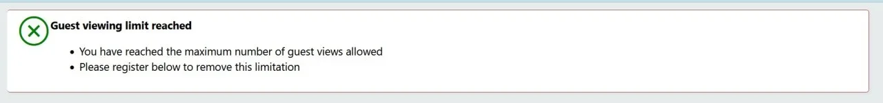

Thank you! This is much better. However I still have a thin red line round three sides. Maybe because I'm not using the default style? I'm using a pixel exit style.
However I changed border-left :0px to
border: 0px
And that did the trick :) (so I just took "left" out). I know nothing about coding btw, just took a guess!
Is there any way of changing the icon? Or just removing it? Your help has been greatly appreciated!
I just changed the colour to white for the icon so it doesn't show. Although replacing the icon with something different to a cross might be nice :-)

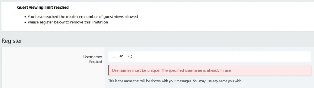

There is another warning still comes up in red if someone tries to then register, and enters a username that isn't available.
That's a Xenforo default alert; I think you can possibly modify that one through CSS with the .inputValidationError location. You'd have to play with the color, background and border attributes just as you did in the previous example.
I assume there is a way, but haven't tried doing it myself. Will take a look next time I swing around to the test site.
Thanks - really appreciate your help so far. The username not available alert isn't a big issue really. The registration warning looks better on my site now with the colours adjusted. It would be great if there is an option to change the symbol but meanwhile I've left it very pale and less obtrusive.
