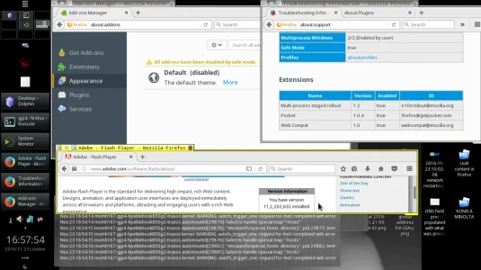

Finding the problem with Firefox in safe mode – with add-ons (including extensions) supposedly disabled – surprised me.

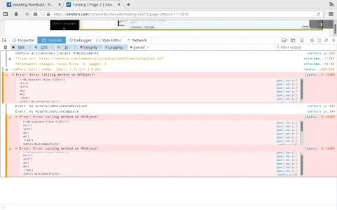

You likely need to open the browser console to see if there are any error messages shown there.
That very much looks like something broken within Firefox. That error would normally indicate a failure to communicate with some sort of external code such as Flash. The area that's triggering it though is just looking for HTML elements in the DOM.
One of those is somewhat tangentially related to Flash, but it's just an input. Regardless, try disabling the Flash uploader.
Perfect, thanks. http://forums.macrumors.com/threads/1990155/ is marked resolved, and renamed:
  • endless progress indicator when replying to a topic, worked around by disabling a feature of XenForo

Side note: the greatest surprise to me (it may be common knowledge to some people) is that whilst Firefox does list Plugins under about:addons, those plugins are not disabled when Firefox reportedly disables all add-ons o_O
– if Mozilla had been clearer about that contradiction in safe mode, we might have understood the problem sooner.
