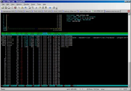

Also install HTOP to keep track of the CPU/Memory etc while logged into the server.

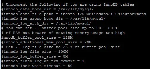

ok my checked my config file , only one innodb setting isnt prefixed with # and that is
innodb_buffer_pool_size=128m

All the other settings are being ignored, as the # makes them a comment, and not an active setting.
Try setting the innodb_buffer_pool_size to 768M as previously stated, and see if that makes a difference.

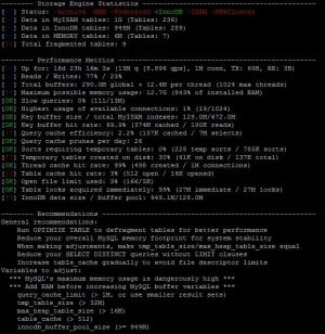

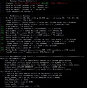

Hmm, there is something setting the maximum ram available to a ridiculously high amount.
It's not looking bad, apart from the innodb_buffer_pool_size, which you could do with increasing.
What else is in your my.cnf file (for MyISAM etc)?
Sorry I uploaded the wrong screen shot - this is the correct one
