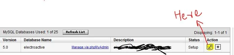

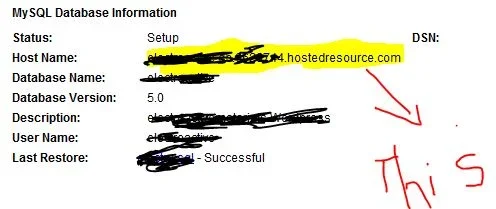

Blandt
#13
Godaddy do not host their SQL servers locally. MySQL server is hosted on anther machine.
your server needs to connect to a remote server.
do not put localhost in the MySQL field.
Here is what you do:
from the hosting control center click Databases
select MySQL
then look for your database you just created and click the edit button
Then look for host name, and that's your db address not your localhost
So in the database field do not put localhost. put that string highlighted ;)
Let us know. oh and why in the world your hosting with godaddy ? :confused:
jadmperry
#14
select MySQL
You're the Man! Worked fine and as of a few minutes ago, www.vetsadvocate.com is live! (Though, it is, of course, a work in progress. You can interpret that as there is no content and it is only live in the sense of it resolves to an "off the shelf" installation of XF).
