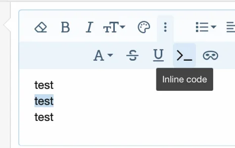

No.However, would you normally have a line break before inline code?
selectedHtml = ed.html.getSelected();
<p>test test test</p>
test
the result of ed.html.getSelected()
is:<p>test</p>
[ICODE]<p>test</p>[/ICODE]
[ICODE]
test
[/ICODE]
<p><strong>test test test</strong></p>
<strong>
because otherwise that formatting could be lost (depending on what you're doing with the selection).<p></p>
if we're working with an inline tag, as we are here.

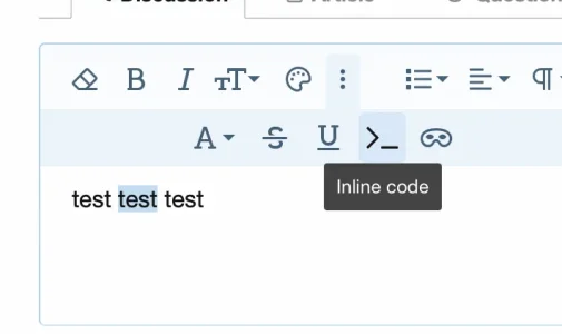

I can only just type some words like this and then select and put into icode.

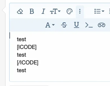

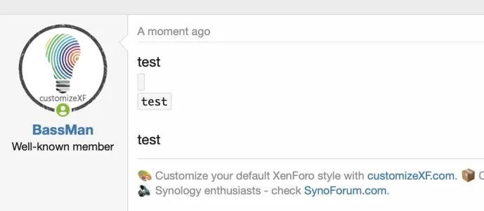

test <p>[ICODE]test[/ICODE]</p> test
test
[ICODE]test[/ICODE]
test
Froala has a bunch of dubious per-browser-type behavior that is hard to troubleshoot. It wouldn't surprise me if it was related.This is an interesting thing.
Since you say "depending on the browser", could it have caused this issue too since 2.2.7?
It adds a 5th parameter toI missed that workaround.

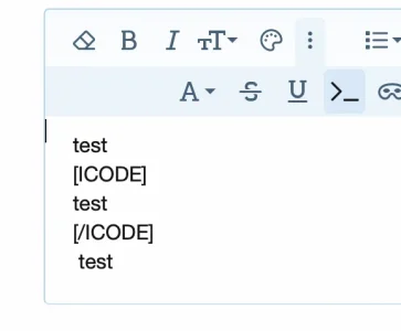

I just implemented it and, while it helps with this issue, what actually happens now is this is inserted (in Safari and Firefox):
