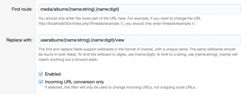

Redirects would have to be done manually, though you might want to see if you can do something with Route Filters. This seems to work:
This is an "incoming" conversion (hence why it kind of looks backwards) but essentially this will redirect useralbums/new-album.1/view to media/albums/new-album.1.
You can create multiple route filters so other URLs are caught, though whether it's possible to do them all, I'm not sure. For this to work, you'll definitely need to retain IDs.
