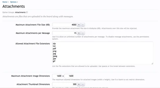

Sizes are set in attachments:
ImageMagick seems installed on the server (semi-shared (enterprise shared))
But when I select ImageMagick in the options in Attachments, it bounces all image uploads that it should be resizing, stating that they're too big. When I select GD, it works fine.
Thoughts?

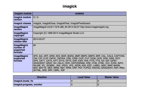

What image types are you attaching?
I've noticed that your supported formats doesn't include PNG, nor TIFF. Mine does and supports 214 formats to your 84. I'm not sure if this is relevant.

I'm not much of an expert, but I know this much, it is possible you have imagemagick installed, but not working because you also need imagemagick PECL installed as well.
I learnt that lesson with my old vBulletin board. If that is not it, then disregard my post.
I believe that Imagick in the OP's screenshot is the PECL extension for ImageMagick, hence it displaying on the phpinfo page.
Usually when I've seen this it has been a broken ImageMagick install. Unfortunately I don't have specifics, but upgrading ImageMagick and/or the imagick PECL extension (which might need to be recompiled if ImageMagick has changed) generally seems to resolve it.
