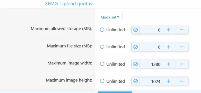

There are separate settings for the gallery. The max image width / height is actually controlled by user group permissions.
Thanks! My images weren't resizing either and I noticed the media gallery was ballooning in size. I didn't know there was an image width and height setting for each user group to resize the images.
I set the permissions as such for the "Registered" user group:
Myself, as the administrator, (but still user group of "Registered") tried uploading a file that was 2000px wide and it did not resize down.
What am I missing to get this to work? Over in the attachments section I only had to set the image width like this and the resizing works fine.

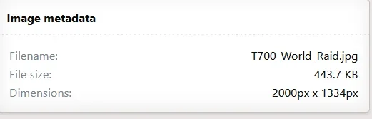

I was incorrect. The images ARE resizing properly. I was thrown off by the metadata being reported in the MG for the image showing the original size metrics, and not the resized metrics:
Actual resized image on disk is about 167k, not 443k. I guess metadata is not updated when resized.
