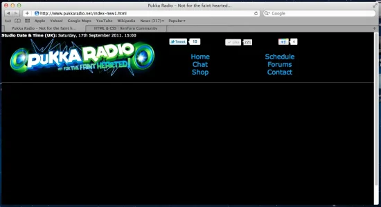

HoddzDJ
I have just done some tweaking and I can get it to display like this... but as you can see it is still not centred :/
HoddzDJ
You need to set a width on your centermypage class otherwise it will assume 100% width!
How would I go about setting the width of the container but still allowing that black bar and grey bottom border to continue and be full 100% width?
