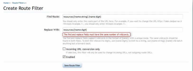

No. I have problem with one of our custom add-ons. We need to shorten URLs.
You can remove titles from all URLs via the options though
Awesome. How can I do that? Would you please giving me the words that I should write in those two fields?
You can't do what you're trying to do in route filters. You can't remove parts from URLs as in general, it's more likely to cause problems. Hence, you would need custom development to change just that specific area.
To remove titles from all URLs, disable the "Include Content Title in URLs" option. (You can locate it via the ACP search system.)
