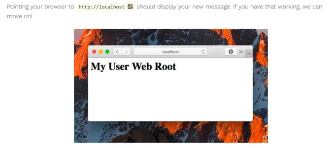

It only shows: it Works!

Dang! missed removing quotes here "/Users/MacHome/Sites" in httpd.conf file...
Finally, it shows: My User Web Root
Thank you!
