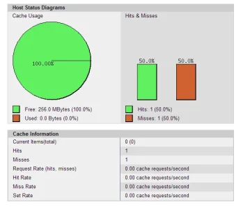

But I cannot see it working on my memcache admin:

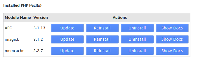

and have you installed the pecl-memcache extension?
http://pecl.php.net/package/memcache
Apparently I have.
