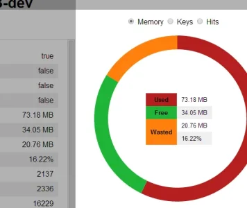

But I cannot see it working on my memcache admin:
I have 35 addons.
Right now I allocate 256MB
Here's mine (just enabled few minutes ago):
Thought my forum is not on peak now, as it's 1AM here :)

Memcache is not use base on your config, you may remove APC line and include Memcache.
// Memcache
$config['cache']['backend'] = 'Libmemcached';
$config['cache']['backendOptions'] = array(
'compression' => false,
'servers' => array(
array(
'host'=>'127.0.0.1',
'port'=>'11211',
'persistent' => 'true'
// End Memcache
