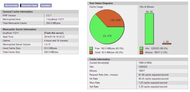

But I cannot see it working on my memcache admin:
So this is now my config:
PHP:
<?php
// Cache
$config['cache']['enabled'] = true;
$config['cache']['cacheSessions'] = true;
$config['cache']['frontend'] = 'Core';
$config['cache']['frontendOptions'] = array('caching'  =>  true,
                                            'automatic_serialization' => true,
                                            'lifetime'    => 3600,
                                            'cache_id_prefix'  =>  'phcn_'
// APC
$config['cache']['backend'] = 'Apc';
// Memcache
$config['cache']['backend'] = 'Libmemcached';
$config['cache']['backendOptions'] = array(
    'compression' => false,
    'servers' => array(
        array(
                      'host'=>'127.0.0.1',
                      'port'=>'11211',
                      'persistent' => 'true'
// End Memcache

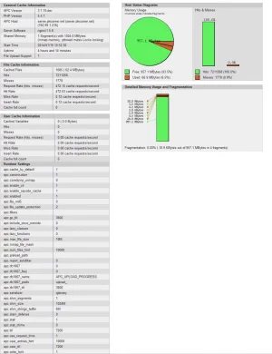

Memcache Stats:
APC Stats:

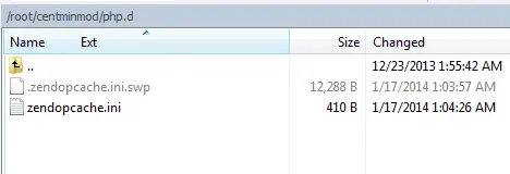

Yeah, that will remove it from use. The files etc will still be on the server, as the are put there by centminmod when it installs it. There is no overhead to leaving them there, other than the small amount of space they are using.
