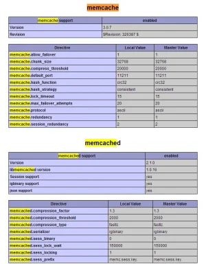

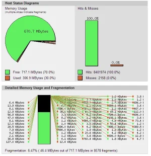

But I cannot see it working on my memcache admin:
You don't need to use APC for the backend if you are using Memcache.
Your APC setting is overwriting Memcache, and using APC for the backend cache.
If you want to use Memcache for the backend, and APC as the OPcache, remove the ACP setting, as it will automatically cache the compiled PHP pages, and the backend will be put into Memcache.

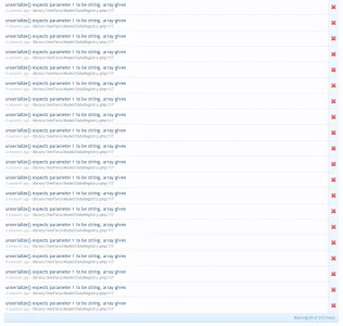

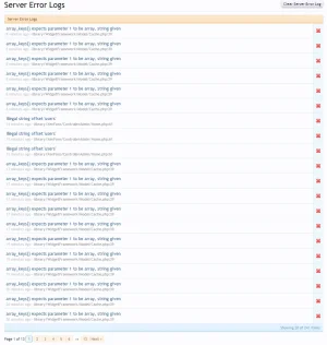

But facing a lot of error now :(
I don't know where to fix.
Already restart the server, doesn't fix.
I'm contacting xfrocks about the BD Widget error.
But the error I'm facing on admin "illegal srtring offset" I don't know what's causing this.
