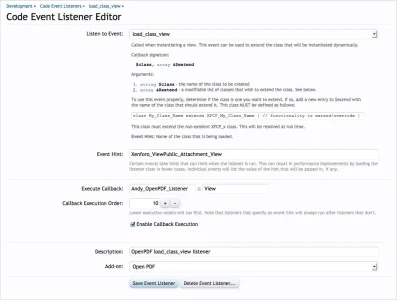

When I create a new Code Event Listener, should I listen to load_class or load_class_view ??
Thank you for your help.
Hi Chris,
I've tried listening to load_class_view, but not able to verify if the listener is working.

Code Event Listener
Thank you, Chris. That was the problem.
I added the "die;" code to verify Listener.php file is working. With the add-on active attachments are broken.
