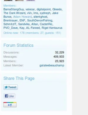

Remove Sidebar Share Page
This is a simple way to increase your front page load time. Simply open the template sidebar_share_page and delete its content. Any time you would like to re-add this to the sidebar, simply revert the template.
By doing this you will minimize DNS look up on the front page. This will not affect all the many share buttons you may have on your forums, threads, or other places. So don't worry.
