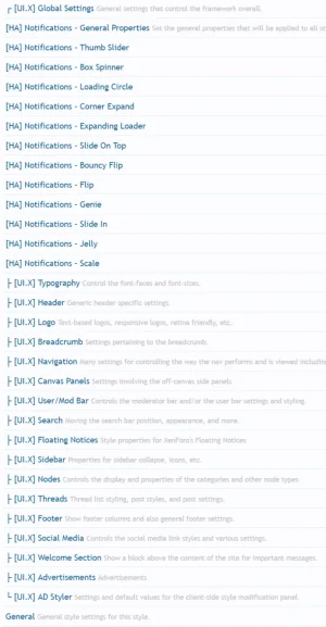

Good addon. I don't know how the ordering is setup for style properties but your notification style props [HA]... are currently wedged between my UIX style properties which makes it a bit challenging. Your other addon doesn't do this so perhaps you should have a look.

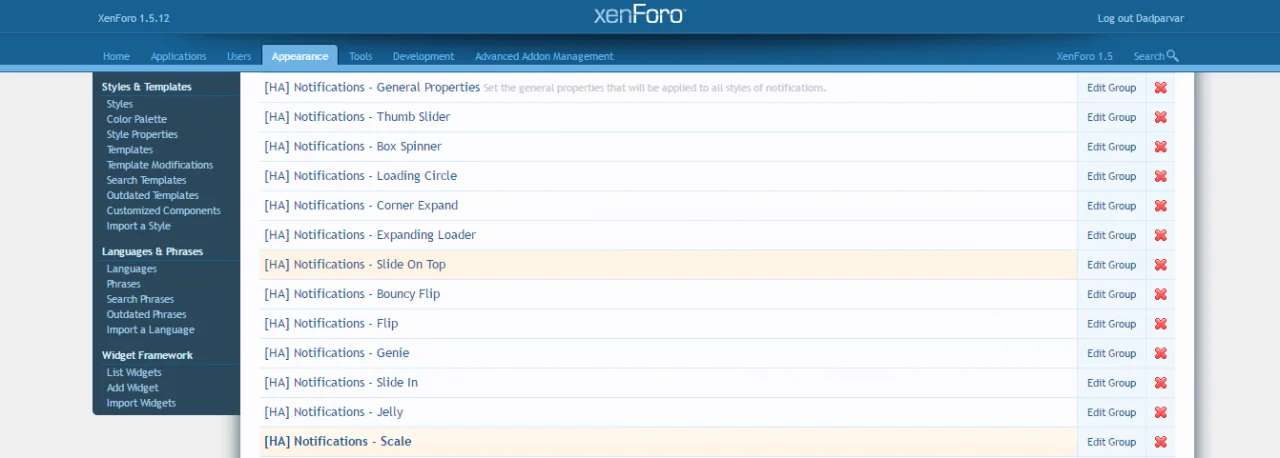

How you mean? My addons always have their own group so that you find things easily. Now what is wrong with this one?
There are multiple designs in this addon. And they are in different positions.
See screenshot.
See screenshot.
they are next to each other. and its good.
your problem is that because they are between [UI.X] ? that is because those are having same order number. (although that is not confusing and I'm not sure what is challenging about it, but anyway If I update the add-on, I'll set a high display number to move them to other places than where [UI.X]s are.)
That's correct, they're breaking up the UIX ones. Not a major issue but confusing.
