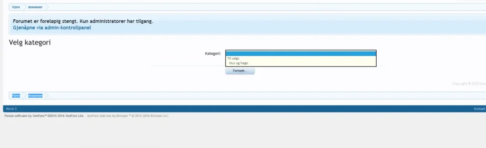

I think i am having a problem, i am testing stuff and i want to register a new classified and on the first site choose category they are all greyd out so i cant select a category, se picture
You'll need to select at least one advert type and one package to allow classifieds in a category.
