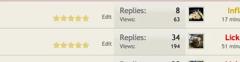

Since I run a motorcycle related site, I decided to try this out for a while.

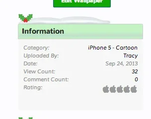

And on my Apple site

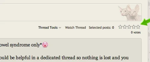

And now it would be completely awesome to have the standard xenforo-ui-sprite.png replaced by a little gem.....so this is a kind of request ;-)
this one.....has to go.....
